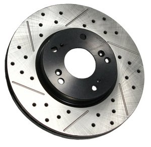

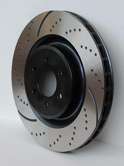

do we have the 321mm vented rear/brembo front or just the brembo front option.... Shows the R1 concept drilled and slotted to be 200 for fronts 150 rear... i could work with that if thats that case.

I thought our rotors are 14.25 ... That 1/4 counts every inch of it
I don't need pads yet I think I'm about 40% left on my pads but I think I'll go with the Pagid Pads when I need replacing
What about our rotors..
For rotors Unless I need em.. I'm not replacing lll
