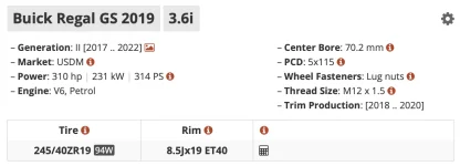

I found the below specs for the GS, Tour X and Cascada on wheel-size.com. It looks like the Cascada rim differences are a +0.1mm larger bore center and +1mm deeper offset. Far as I can tell they should be a fit then. I'm a little worried perhaps the Brembos on the GS could cause an issue that wouldn't show up on the Tour X. Looks like I might have to take a chance and find out. I will be running the 5mm spacers to account for the 10mm wider tires. Hopefully the lugs have +5mm to spare.
That Insignia is sharp, I saw that one also. I'm on the fence regarding the black window trim and would lower it a bit less IMO. The black roof looks really good though but not sure if it'll look like "too much" in reality.
GS:
Cascada:
Tour X (known fitment):

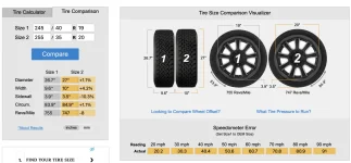

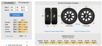

So I just realized I screwed up sizing of the new tires. I originally started with 245/35/20's because the sizes were identical. I bumped them to 255's bc that is a std size for the BFG's, all I'd have to do is run a 5mm spacer to keep the inside edge of the tire same as stock. I figured the resulting extra 10mm of offset outside would look good so win/win.
I forgot the "35" is a percent of the 255 not a fixed sidewall height as I had previously thought, therefore the diameter is now larger by a bit. Any idea if this additional 0.3" diameter is going to be a problem? Looking at the below the rev/mile count is -8 and some small differences. Im mostly concerned about fitment.
255/35/20 vs stock:
245/35/20 vs stock:
