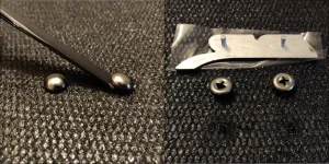

  1. Remove the 3D emblems by getting underneath the metal buttons and prying. If you want to, these buttons can be epoxied back on the mats for an original and clean look. If you don't intend to reuse them, simply tear them off with a pair of pliers. You can see that the buttons are just pushed onto the aluminum 3D emblem posts.15924

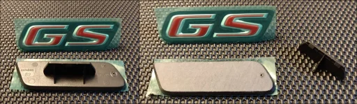

  2. Time to prep the GS emblems. The tab shown on the left needs to be removed, this is where the saw comes into play. Once the tab has been sawed off, place the sandpaper on a solid flat surface and sand down what is left of the tab. A rough grit is desired here because it will create a better surface for the epoxy to adhere to. It doesn't hurt to clean the surface while you're at it.15925

  1. Remove the 3D emblems by getting underneath the metal buttons and prying. If you want to, these buttons can be epoxied back on the mats for an original and clean look. If you don't intend to reuse them, simply tear them off with a pair of pliers. You can see that the buttons are just pushed onto the aluminum 3D emblem posts.View attachment 15924
  2. Time to prep the GS emblems. The tab shown on the left needs to be removed, this is where the saw comes into play. Once the tab has been sawed off, place the sandpaper on a solid flat surface and sand down what is left of the tab. A rough grit is desired here because it will create a better surface for the epoxy to adhere to. It doesn't hurt to clean the surface while you're at it.View attachment 15925
