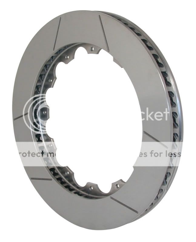

Anyone want performance rotors for the GS??
synolimit
387
Akron OH
2012 GS
When I had my WRX's the OEM brakes were horrible!! Very small with lots of fade. They were 11.6" rotors with under an inch in thickness with single piston one sided calipers. The STI had Brembos 4 pistons with 12"+ rotors (not the real deal like a race kit, what we have that are good but not the best). So I wanted to upgrade. There were some nice street kits out there but nothing what I wanted for the track. They had decent calipers, 4 piston or 6, ok sized rotors, 12" I believe etc. But just not what I really wanted. Then I came across a guy that made custom brackets to use 14" x 1.25" Wilwood rotors and their race HUGE 4 piston or 6 calipers!! It was the best thing I ever seen.
The point of all that is Wilwood makes some nice rotors. In my research to save money on the kit I thought about not buying their rotors but using solid rotors from a factory car like ours (14" x 1"+ rotor). The problem though was gaining weight. Solid rotors like ours are 20 or even 30 lbs (I can't remember). Wilwood uses aluminium top hats then a slotted, drilled, slotted/drilled rotor. If I remember the weight was only 17lbs. It was a good 5-10lbs lighter! That's a huge amount off unsprung weight vs like removing 100lbs from the trunk.
I know this isn't a race car but who would add these to there car for the look, lighter weight, better performance on the street??

Ok i just took off the OEM rotors and got as many measurements as i could. i am blown away at what size these things are!!! the rear GS rotors are bigger than my WRX's front rotors! thats crazy and there as big as a STI's front with brembo calipers!! with these sizes you could track this car no problem and not have to worry about fade since the heat has so much room to disapate (of course you'd want new fluid, pads, and SS brake lines to go with).

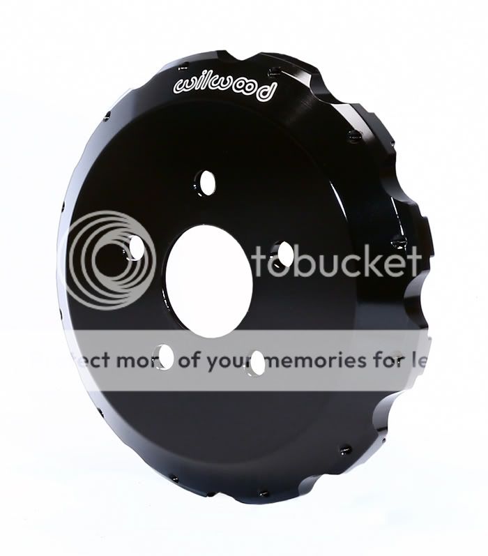

ok i called up Wilwood and we got as close to OEM size as we could. my way of measure the offset and back spacing is not 100% on. the things i know that are 100% are we need a top hat with a 5x4.5" bolt patter (thats a 5x120). we also need a rotor that is 14x1.25" for the front and the only thing they have is the GT72 in that size and thats fine because its the most bad ass rotor they have.
now where it gets tricky with my measurements. i measured from where my rotor was sitting on a table to the back of the rotor where it sits against the hub. im sure i was a little off because i had to use a bolt and write on it with a pen because my caliper couldnt measure that like that. i got "1.62 inch". now if you subtract the thickness of the rotor you sould get the offset, 0.37". now Wilwood doesnt make a 0.37" offset. its either a 0.35" or a 0.41" in a 5x4.5" hat. we can rule out the 0.35" hat because that hat will not bolt to a rotor big enough in our size (14x1.25"). so we have to go with the 0.41" offset hat. lets just hope my writing with a pen and then measuring is a little off. however 0.04" is only 1.016mm so it should bolt in and be fine being that small.
now the other numbers that are not an issue and are 100% correct are the OEM hub hole and hat thickness from the back to the front where the wheel bolts to. our hub hole is 2.65". the 0.41" offset hat has a 2.8" hole. but since the hat sits in the studs the hub hole sould not be an issue. if is was smaller then yes that would be an issue but bigger should be ok. as for the hat thickness the 0.41" offset hat is only 0.27" thick. our OEM rotor is 0.33" thick. what that means is our wheels will be pulled into the car an extra 0.06" or 1.524mm. i know most people want spacers to kick the wheels out and someone on here has installed a 20mm spacer so you could do that. again it shouldnt be a problem only coming in 1.5mm. no one can really see that with the naked eye.
as for weight. the OEM rotor is 24.96lbs. getting the GT72 rotor and aluminium 0.41" hat the weight savings should be 5.46lbs. thats a good amount off the drive train having to spin that up times 2! add some lighter wheels and tires and she should start to take off a little faster and free up some power.
im still working on the rear rotors. its not looking to good at the moment. heres the part numbers so far.
160-8398 rotor, retail price $284, cheapest ive seen ebay at $250
160-8399 rotor, same above
170-6223 hat, $170 times 2, cheapest ive seen summit racing $158

Can anyone confirm if these part numbers will work, or has anyone tried at least? It's a bit much for me to spend on trial and error. Worst case scenario I'm going with slotted rotors and OE GS pads from a 2013, the pads on my '14 are a joke
