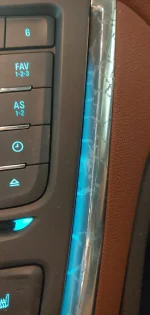

I would like to remove the thin chrome trim piece that frames the center dash controls on my 2014 Encore. The chrome overlaying the plastic has blistered and is flaking off. If I can pop off that trim I could sand off the remaining chrome overlay and either paint it flat black or try to do a wrap. I am scared of popping it off and breaking it. As I test prayed it up, it looked like lighting wires are connected to it. Any advice would be most helpful. Please see photos:

I've never had mine apart. Once you remove the whole trim you should be able to see if it is glued, screwed in or simply snaps together. Electrical connector is a simple push tab to remove and wire is long enough that you don't have to worry about breaking it. I believe it is on the left side. Just be careful. Panel is only held in place by 5 spring clips like these.

You need to get a trim tool, soft nylon type works the best, the red ones at Harbor Freight are a little rough IMO. Start at the top on the one side popping it loose and slide it down popping the other holders loose, time is your friend so going slow and don't force it. As far as the repair the chrome on the plastic will probably need to be removed as any type of covering paint or vinyl will show the cracks so consider on how and what will be used for the finished product.

I haven't refinished the part yet. I think a chrome vinyl wrap would look best. Even spray painting it in a flat black would look better. I have 125,000 miles on the car and now the GPS acts "drunk". As I drive down the street with the moving map on it starts to spin and wander off the street. If the 50 cent trim piece is $180 I can imagine what the GPS repair would be? Looking at buying a Tesla Model Y. Drove a demonstration one in Naples. . . very impressive.
