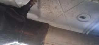

So my husband crawled up under the car and found that the wiring on the down stream O² sensor are missing completely as though someone cut them off would or could that make the car shut down?IMG_20251114_142935.webp he then realized it's not the downstream sensor because it's on the catalytic converter itself. What is it?
That's the downstream O2 sensor. If the wires are missing/broken it will not cause the car to stall. It will set codes, effect gas mileage and emissions and may run rough at times. As said earlier check the MAF sensor, that will cause stalling/cutting out
