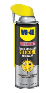

I use this WD40 Silicone spray on the window tracks and rubber pieces. My driver side window would stick, I sprayed this in the rubber and down into the tracks. Window works smoothly now, no more stress on the motor. I just saw the Scotty video above, LOL! Same stuff he uses, or recommends.
