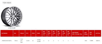

I'm not a fan of the factory wheels. Thanks for all the options, GM. I'm thinking about the wheels below. According to the manufacture's web site they fit. I can't determine how wide the factory wheels are. Anyone know? Other ideas? Thanks.

I haven't found actual conformation from Buick/GM, but this site says 18x8, 40 offset, and 5x115 bolt pattern:
Buick Regal TourX 2018 - Wheel & Tire Sizes, PCD, Offset and Rims specs
I agree with you about the OEM wheels. Even the higher trim levels of this car still come with the same frumpy ones. I plan on changing mine over when the stock tires wear down.

The specs BrianCoasters posted are correct. My winter wheels have a larger centerbore so I used some hub centric rings to snug them up perfectly.

I've been researching a bit. It looks like the Lacrosse wheels are the same size/bolt pattern/offset. Kinda liking these.
Also this Verano wheel is the same but the offset is 46 not 40mm. I'm guessing 6mm would be noticable? I like the Verano better.
