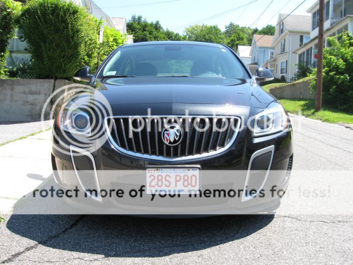

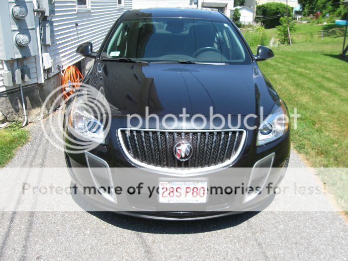

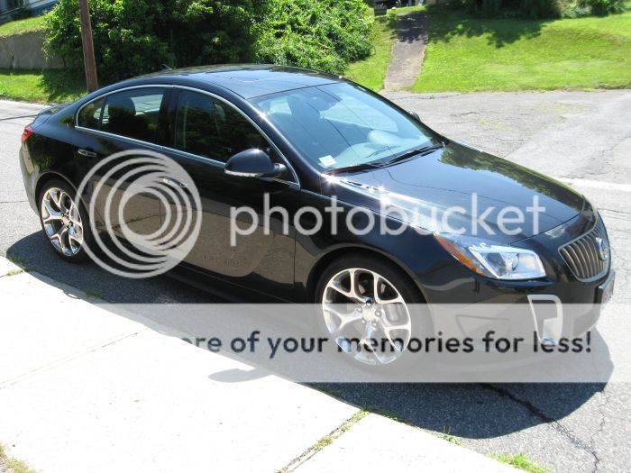

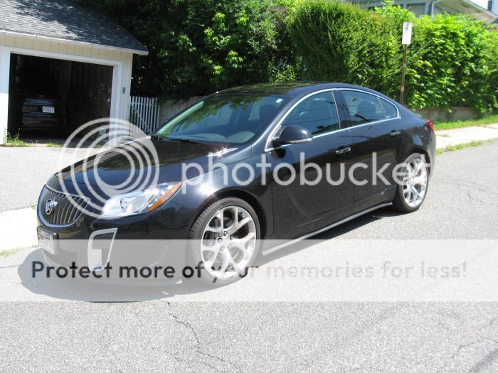

Just finished this afternoon.
TprGTO
921
MA
2012 Buick Regal GS
I decided I wanted to give the car a slightly lower and flared look. Most of all, flow with the lines of the car.
I purchased from Ebay, 24 feet of high silicone flexible rubber splitter, 3m adhesion promoter, a 45' roll of 3m vhb double sided tape, self tapping screws with washers. I unclipped the front plastic piece from the bottom of the front bumper. Applied the adhesion promoter to the rubber where the tape would be applied and let dry. Then laid the strip of 3m tape to the rubber. I had to cut a series of v notches in the rubber around the curve of the front bumper so it would seat flush. Finally, cut the ends and then screw into bumper and side skirts.

Drilled new holes.

I noticed the material is slightly dull/matt finish. I brushed a coat of the 3m adhesive promoter on the splitter/side skirts and it now has a slight shine to it. Looks good afterwards.
