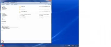

The map SD card is inserted next to the two USB ports under the center armrest. I was told this afternoon by Buick that the latest SD card for Maps is the one with part number
Navigation SD Card # 8436 4481
When you google this part it comes up as a Cadillac Nav card but was assured by Buick customer service (not the dealer) that this is the latest available for any GM car (even though the card has 2017 data).
I removed the card and opened in my desktop to reveal the attached files. The date of Nov 16 2018 is the date the salesman brought the card to my home. Apparently, the vehicle tags the card so that it will not work in another vehicle (thus the mystery that the cards are VIN specific...can't take my card and use in a different vehicle).
