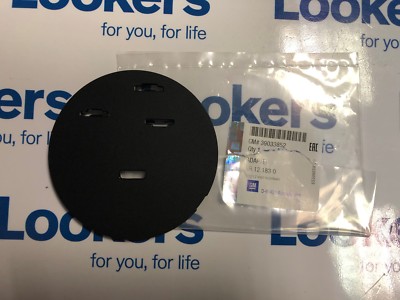

The Vauxhall parts are pretty easy to come by--Ebay for the most part; plus the grille & trimmings are the same as for the Opel conversions (hey, Insignia's are Insignia's!).
I wouldn’t be surprised if the Holden grille is the same part, too as the badge diameter looks to be the same (not verified tho).
I don't know how accurate that is. Looking at the Opel grill parts, the shape of the chrome Opel emblem is molded into the black plastic grill. A Vauxhall emblem does not look like it would be "plug n play". Same for Holden. You can see the"Blitz" shape in this picture.

I’m pretty sure the Holden/Vauxhall badges simply cover up the blitz shape when installed. Poke around on some Vauxhall forums and you’ll see this mentioned.

That's what these are used for.
