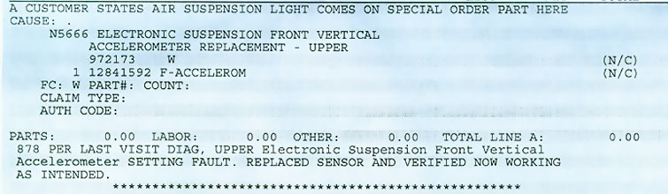

Yep, happened to us. We test drove one T07 and decided on another color without driving it. After it was new car prepped, we drove off the lot and noticed the warning light and u-turned back into the lot. Service was not available to look at it was Sunday so we came back Monday. They could not duplicate the error message and there was no error code in the
computer log. They came to the conclusion that it was a faulty sensor and ordered a new for us. Hopefully enough people report it so Buick figures it out.

Mine came back on again today. I promptly called onstar and they didn't see a code. I'll be taking the car in on Saturday to get a sensor changed. I'll report back with what part they changed.

dealer replaced suspension control module, was good for 2 weeks now it is doing the same thing. can you spell L-E-M-O-N-. This is the 2nd attempt, they only have 4 attempts per my state law.

I was pissed and venting. It was not just a silly suspension light. The car rode like a brick. The first time it came on they replaced the suspension control module. The second time it came on a pin from a wire had come out of the module. Seems good so far. A stupid annoying problem for such a GREAT car.
