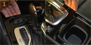

  1. Slide the front cup holder cover open fully so it's out of the way. Once this is done, with both hands grab the edge of the plastic and gently but firmly lift up.
  2. Two of the seven clips have now been released. Three more are in the middle, and the last two are behind the single cup holder (skip to Step 10 to see where these clips are located). Now, work your fingertips along the edges to pop the other clips. Be very careful not to apply too much pressure on the narrow portions around the cup holder. Just keep working your way around until they are all free. 15778

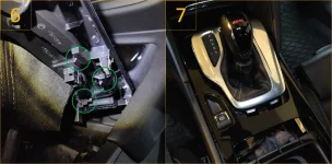

  6. Now detach the center chrome trim piece. There are six small clips around the outside (circled). It helps to apply pressure upward to prevent the clips from snapping back in place while you tackle the others.
  7. Once all of the clips are free, the center trim piece slides towards the front of the vehicle. 15782
