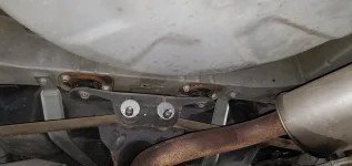

What are these called?

Good question. Those go between the frame/subframe and the lateral link bracket - I just replaced those lateral links in my PA recently and had to lower that bracket to get er done. I wondered the same thing but left them as-is and bolted the bracket back up.
Looking at RockAuto I'm not finding anything close either...

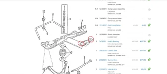

I found this
but i dont think its right.

I believe you may be looking for these parts, unfortunately no description on the part# but could assume it's L&R. 2005 lesabre as I didn't see a year listed.
4415887238BRACKET, RR SUSP SUPT INSL
4425650403BRACKET, RR SUSP SUPT
4515237958INSULATOR, RR SUSP SUPT (FRT)
4515237959INSULATOR, RR SUSP SUPT (FRT)

It's not that. The mounts are at the rear of the car.

I also think #14 is the closest in that diagram.
The lateral link is the bar #26, which goes up into the bracket resembling a hitch. Above that hitch looking bracket, guessing #14 goes on both left and right side there.
I forgot that bracket is part of that huge member, I had to pry the bracket down 1-2 inches after releasing the bolts in order to get the lateral link bolts out and away from the fuel tank.
