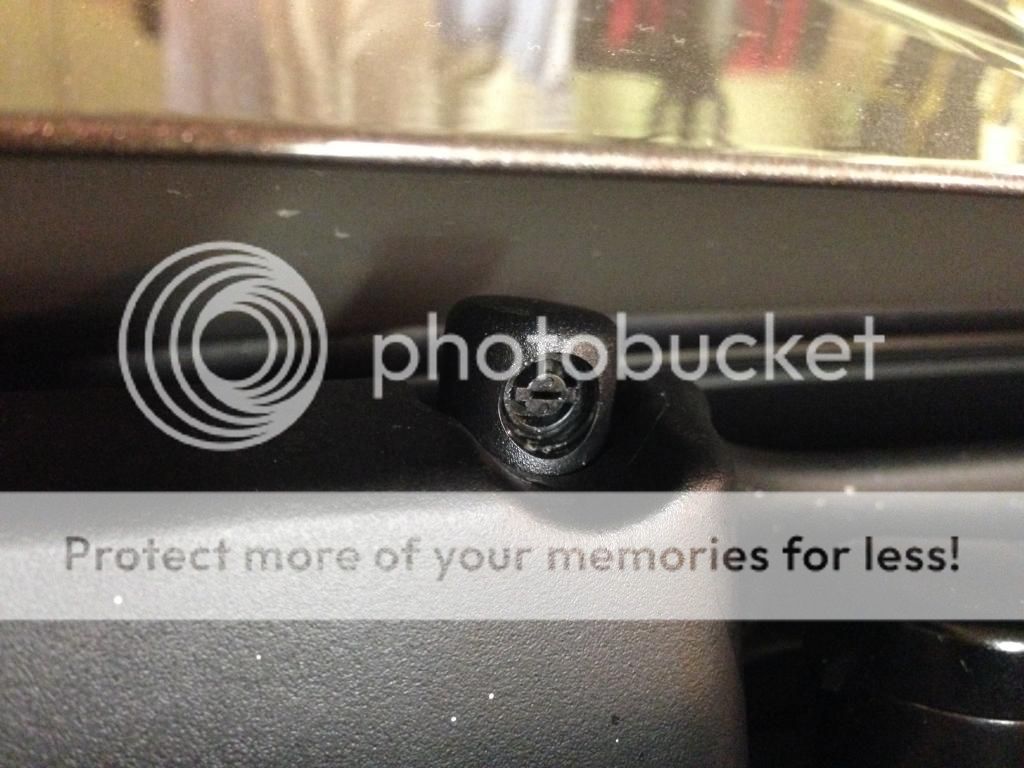

Had my new '13 Deep Espresso Brown Encore Leather for a couple of weeks now, and I love it.
I have noticed that the windshield wiper spray hits the windshield very low. It basically hits just barely above the wiper themselves in the resting position. Is there a way to adjust this higher up this myself?

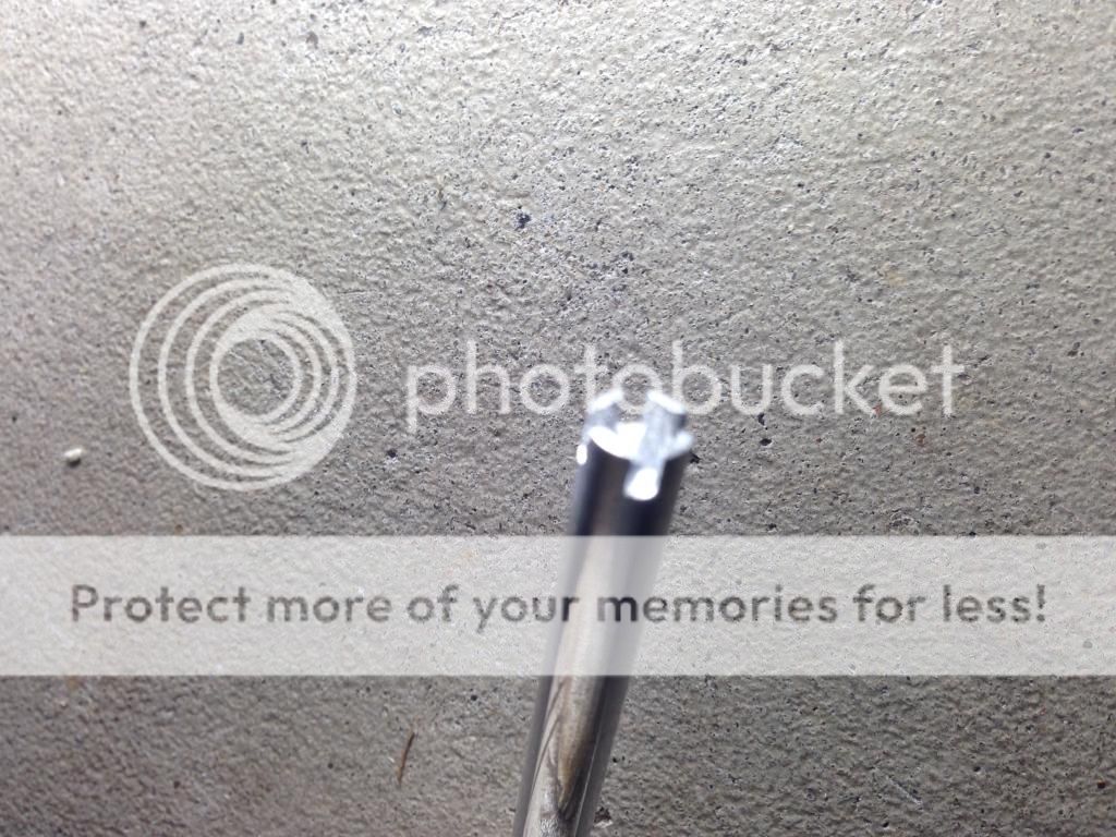

yes, i had to adjust mine since all dealers say they are not adjustable but they are, you need a special tool available on ebay for about 11 us dollars, please look at post from about late august or early Sept for washer nozzles there is a post with photos of the tool . i will give you more info when i find the earlier posts ---jimt
jimt
19
more info , if you go to EBAY search for item number 25133023089 or type in the following exactly as i saw it on EBAY - (Vauxhall Insignia Astra J FAN style washer jet adjusting jet tool) that should get you to it. PS the nozzles need VERY little adjustment , so if you do it yourself make small incremental adjustments they will spray so much better good luck jimt

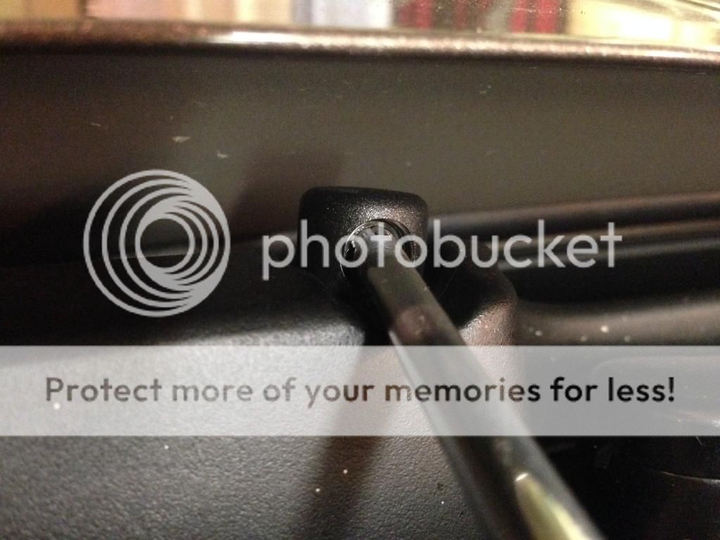

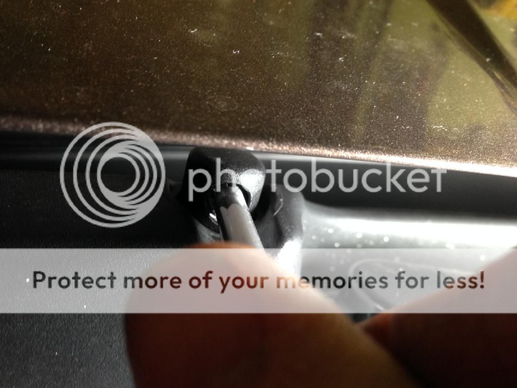

Hey JIMT -
Bought the tool – Now what? :confused: Once inserted do you turn it? Push to one side or the other? What? Dinner was on the table so I didn’t fool with it much - Photos forth coming J

Did they adjust? Did they move at all? Did it make a difference? Do I know what I'm doing? :blink: Not yet sure... Will have to see how they work on the road. ;)

I just got my adjusting tool as well and tried to adjust them. Is it just the middle part that gets adjusted or does the whole little nubby thing move? I'm not sure if anything changed or not for me.

I just don't know/understand - finally drove the car at highway speeds the other day and saw that the sprays were quite low & useless!
Tried once again to adjust, kinda noticed that they seemed to "push in" a bit but still can't seem to make them spray any higher??
