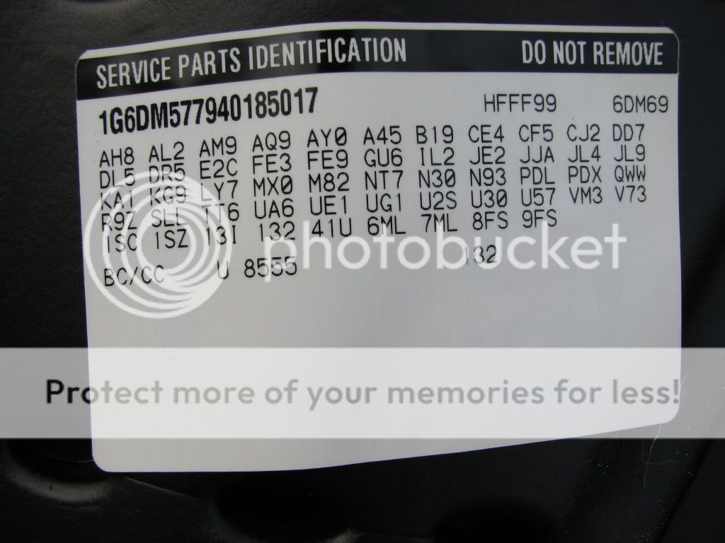

*In my best Beastie Boys voice* "DRRRRROP"! &#9818; Master Thread &#9818; <--- I'll just leave this here.
I didn't forget. It took a couple of weeks, but I got 'em. (I made sure to perfectly cut the pages this time) *wierz11 would have my ass, if I didn't*
For the people that can't read these, you should look in your trunk for the "Service Parts Identification" sticker. It will tell you exactly what SYSTEM you have.
The sticker looks like this..... (random photo)
Any questions,,,,,, I'm here. Good luck and pimps up.

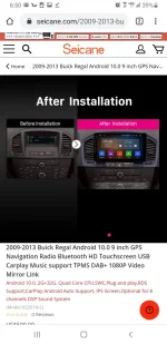

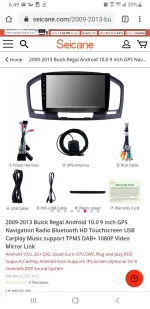

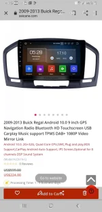

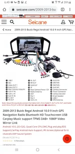

This is the closest thing I have found to help remove the head unit, 50 Steps on How to Install in-dash Car DVD GPS player in Buick Regal
I will be installing some 6X9's in the empty spaces in the trunk so I will have to run new wires to the head unit. I will post what ever I can to help. I have also read that it's not a good idea to install an aftermarket amplifier on the stock head unit. For it to work well you have to get an aftermarket head unit. Please post what ever you find also.
