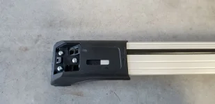

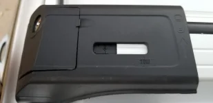

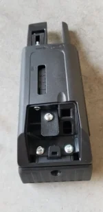

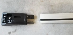

Very good description of the noise, I heard the exact same thing at the same speeds. Thanks kwsims for trying different positions, you saved me the trouble of doing so.
But it's getting more interesting ... after reading kwsims' report, I decided to try and mount my old Rhino-Rack bars on the Cowvie legs, and see if I can reproduce the noise. Luckily the legs and bars are compatible, and I could mount them securely. I went for a short drive tonight, speeds up to 70 mph, and no noise! Well, there was some really minimal, but nothing even remotely comparable with the Cowvie bars.
Now I am inclined to not return them, and use the Rhino bars instead. I attached pictures of the new combo and the two leg systems.

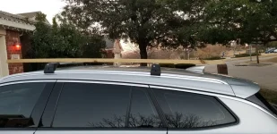

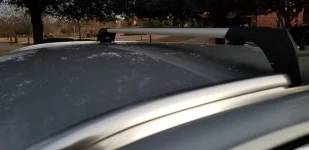

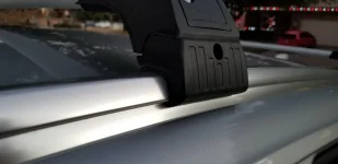

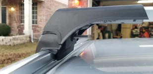

So I purchased the silver set from the OMAC site and tried them out today. Aerodynamic style bar and virtually no noise at any speed and rated for 165 lbs.. Much better regarding noise than the ones I tried previously from Amazon. They have a t-bar slot that is covered by a rubber insert and the set is adjustable regarding fitting the width of the car. One bar is longer than the other and it had to go towards the front with the shorter bar in the back. I positioned the bars forward and aft so I could put a 2x4 on there just to see if it cleared the shark fin antenna in the back and it seemed to work. Not sure if I will use the racks that often, but it seems like they would be useful for the occasional odd job to carry lumber or plywood from a big box store or if I get a cargo carrier box later on. I think this set mimics the Thule ones that are of similar style. Only thing that concerns me is the portion where the aluminum bars slide into the plastic piece that attaches to the rail. It is completely plastic, though it does seem study. The other option I was considering was from Micks Garage with the Nordrive telescopic aluminum roof bars. Those seem to be rated for a little bit heavier load, though I don't think you can exceed the limit of the roof rails on the Tourx anyways. If anyone has tried the Nordrive, please post opinion if you have one.

@kwsims those OMAC bars look really good. I see you mounted them quite far apart from each other.
