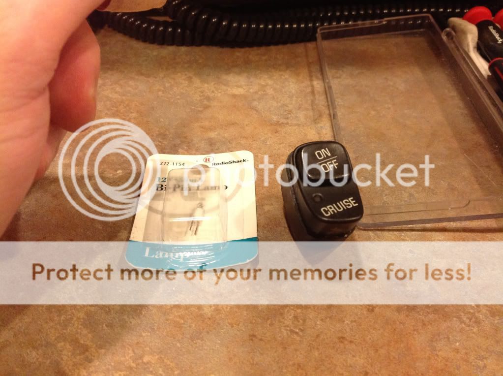

This is a quick guide for replacing the button back lights on the steering wheel or environmental controls on 00-05 LeSabre. The replacement lights I used are available at Radio Shack for about $1.97 eatch.
For illustration, I am replacing the steering wheel curse control lights in a 04 LeSabre Limited. The process and replacement lights work in environmental controls as well once you get it apart. LED's can also be used but they need to have an internal resister to work on 12v. If using LED's check to make sure youn have the polarity correct (+/-) before soldering.

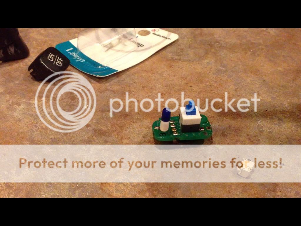

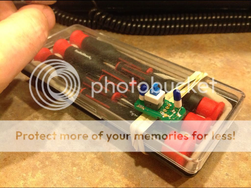

This is the circuit board. The light on the left has already been replaced, the one on the right (vertical) is original.

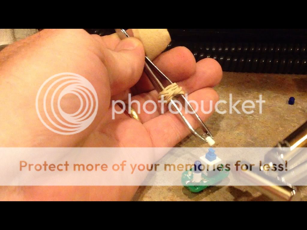

The lights are soldered on the top of the board wich makes them easy to remove. Just use a soldering iron to melt the solder and pry the light up one side at a time. and don't worry about melting the plastic base on the existing light.
. Remove the blue rubber cap on the old light. It will be reused on the replacement. If it does rip, or gets ruined, it's not the end of the world. The new light will just be just slightly brighter and more white then green.

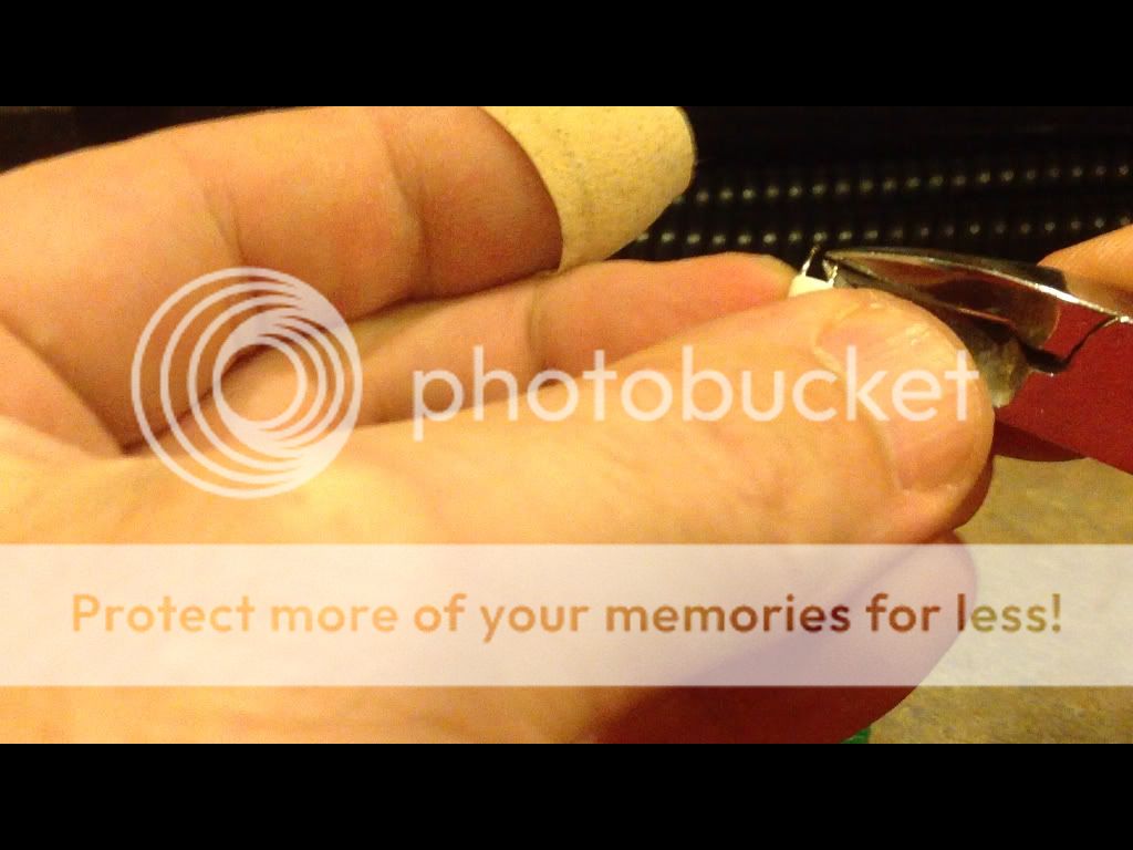

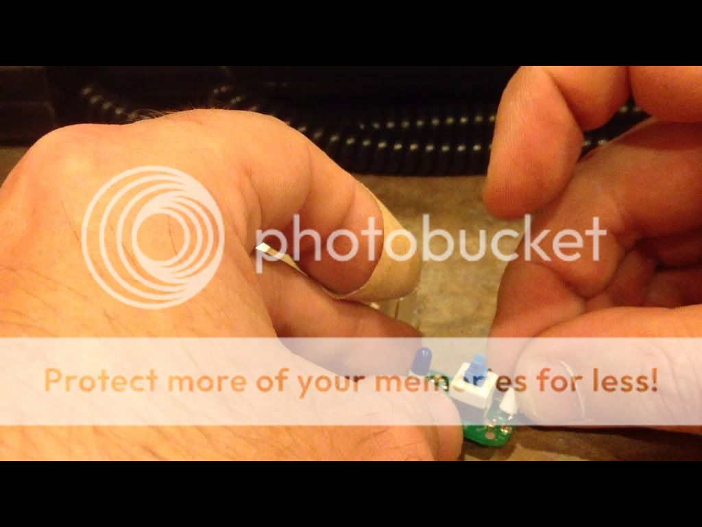

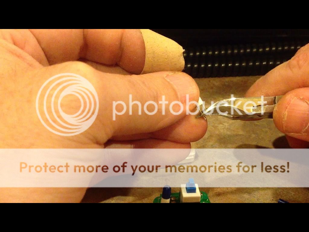

Cut the leads about half way down and bend to about 90 degree angle. If your mounting the new light on it's side this will also work.

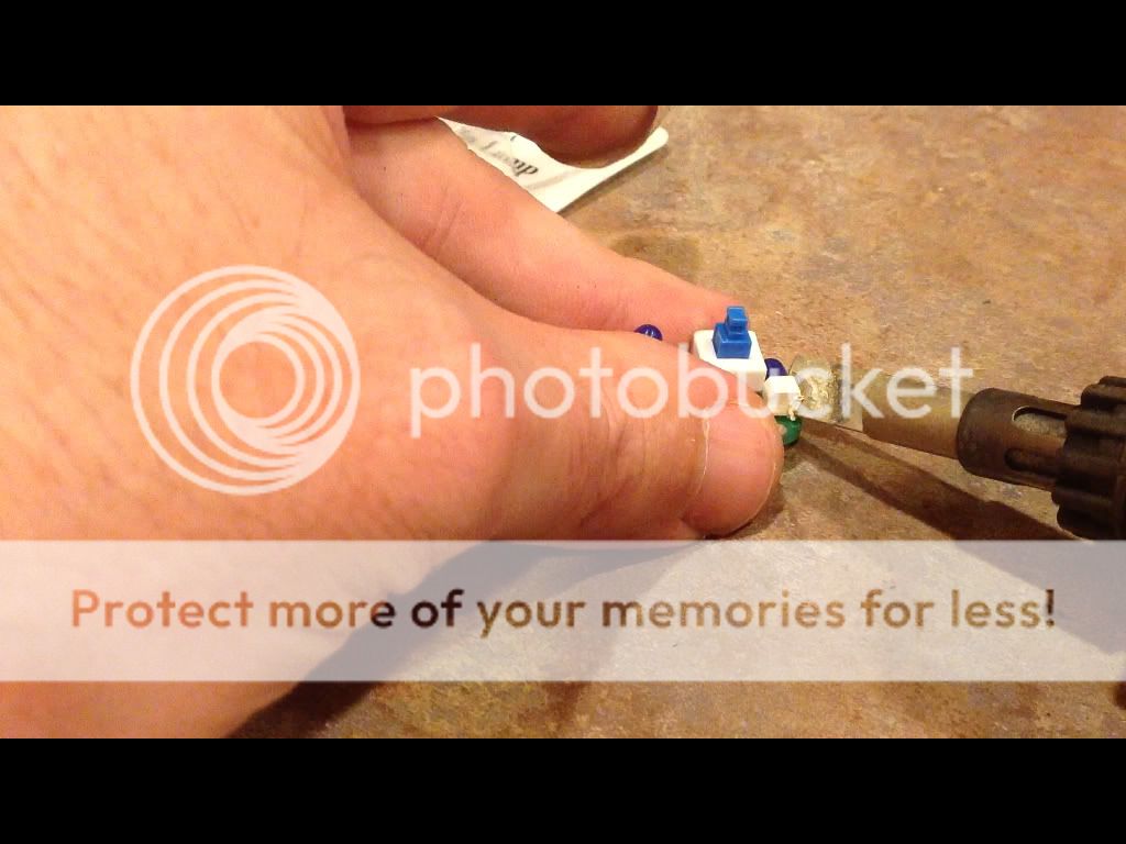

Tin the leads with solder. This will make it much easier to solder them on the circuit board. Simply hold the new light in place with the lead on top of the circuitboard's solder joint and appliy heat.
Replace the blue cap and your done.
End result :
