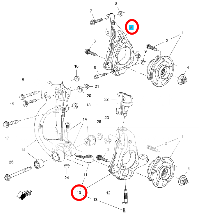

Anyone know if those can be installed on the Turbos? The 19" wheels seem to have plenty of room.
The hub is different on the GS. Not plug and play without replacing the whole front hub. It is possible though.
Not happening. Their website lists up to 2004 for the Regal.Check out r1concepts.com, they have superior customer service, and stand behind their product. I've found making a phone call actually improves the price, they'll usually offer you a package deal which beats their internet price.
the oe wheels on a regal turbo also have wrong offset
As Laloggia says there are differences. The hub is actually the same but the steering knuckle to which the calipers mount are different. The diagram below shows the steering knucle for the GS (#10) and the non-GS models (#5).
