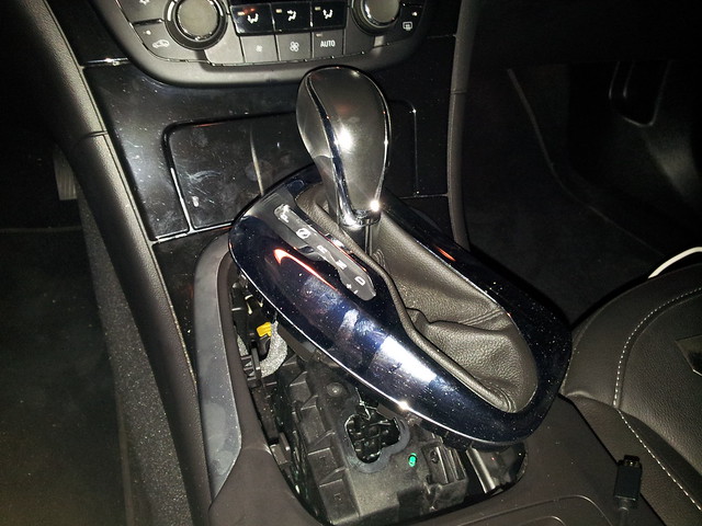

So I decided to be a guinea pig and paint my chrome bezel. Used the information from member tban70 and followed his advice on prying the bezel loose. I put the car in neutral and used a couple of plastic "tools" to pry the bezel loose. Started with the end close to the dash and worked my way back toward the cupholders. And then finally:

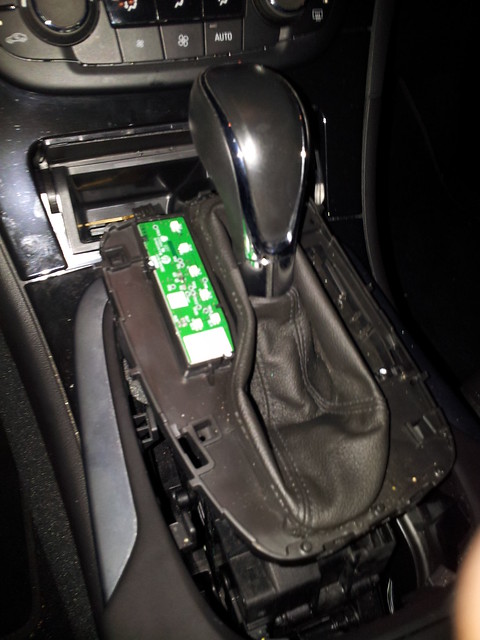

I unplugged the wire to the light for the gear indicator. Separated the chrome bezel from the black plastic.

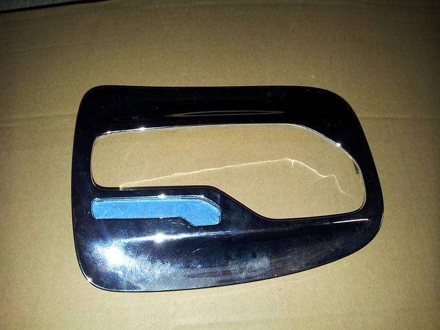

Be careful not to break one of the plastic tabs that connect the two pieces together. You can see one of the tabs that I broke below. I then sanded the chrome piece as you can see below as well.

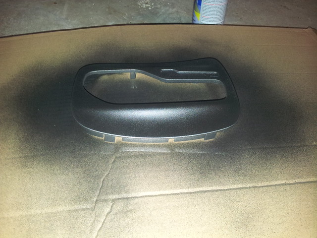

I used Krylon indoor/outdoor semi-flat black spray paint. I painted four thin coats waiting a couple of minutes in between each coat.

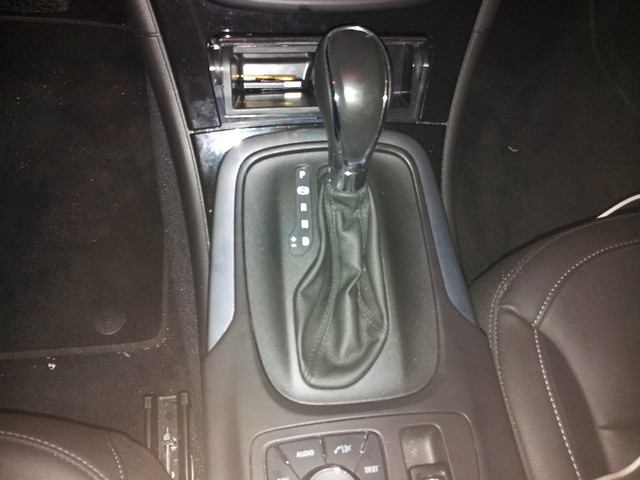

I then connected everything back together and this is the finished product:
We will see how it holds up over time.
