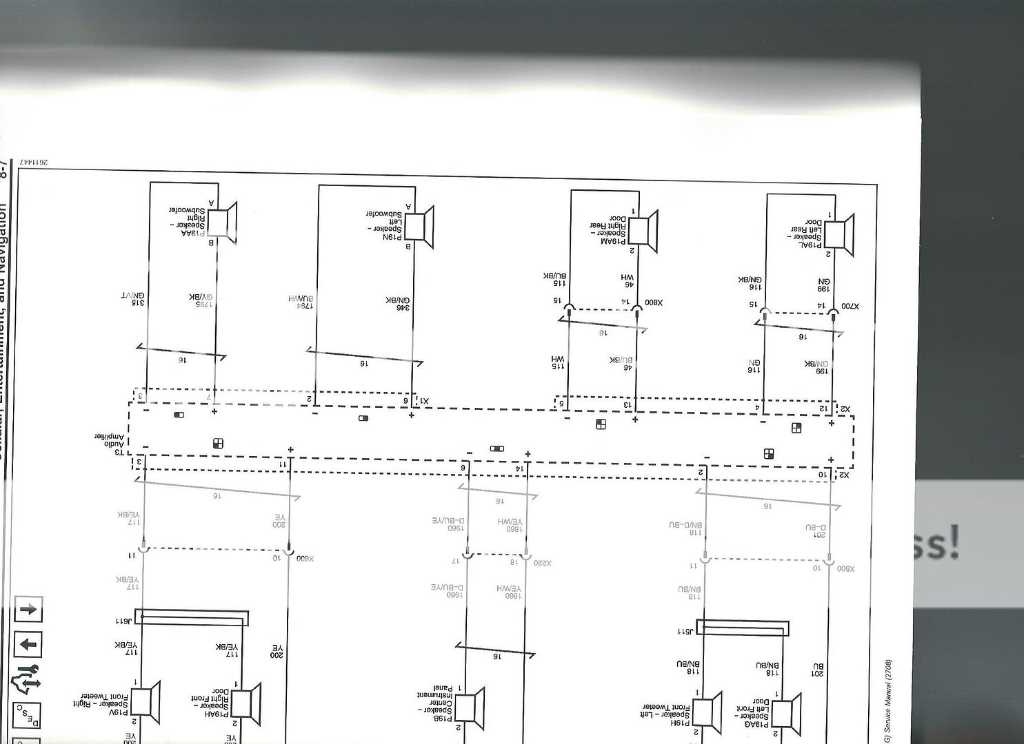

Also, those wiring diagrams you posted, any chance at a larger version? I think they might be helpful but I can't make out any of the writing.
Thanks again!
Because forum searches don't work very well, unfortunately.
I'll see if I can get them larger in the morning.
The best I can get up for now. I'll cut the pages out of the 2012 service manual and scan them when I get some time.
I can attest that all of these wire colors/colors are correct for the 2012 Regal Harman/Kardon system. The amp in a 2012 Regal is behind the carpet in the trunk on the right side, near the taillight.
If you have a "base" system,, you might not have an external amp. Your speakers might be powered by the Head Unit. (just a guess, I don't know for sure)
Hope that helps.
Thank you again for the images. They should be large enough at this point. As to the location of the signal, it hadn't occurred to me that there isn't an amp. There is something there, but upon unplugging it, I was only successful in preventing my engine from starting. ECM or the like I would think. Also the harness had four 14 awg wires at the four corners and the wires in the middle were all 16 awg. Also, when unplugged my audio still played.
