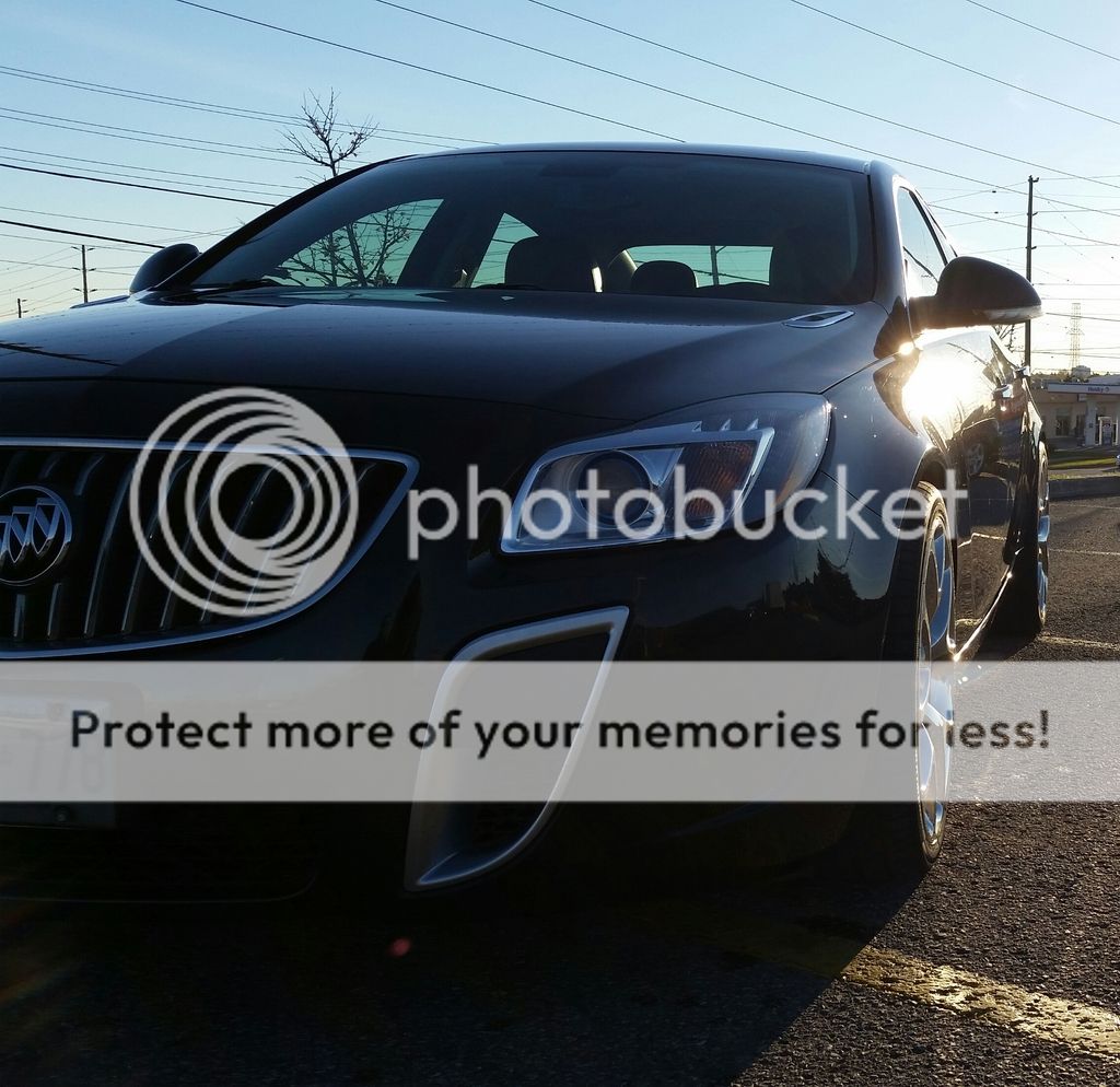

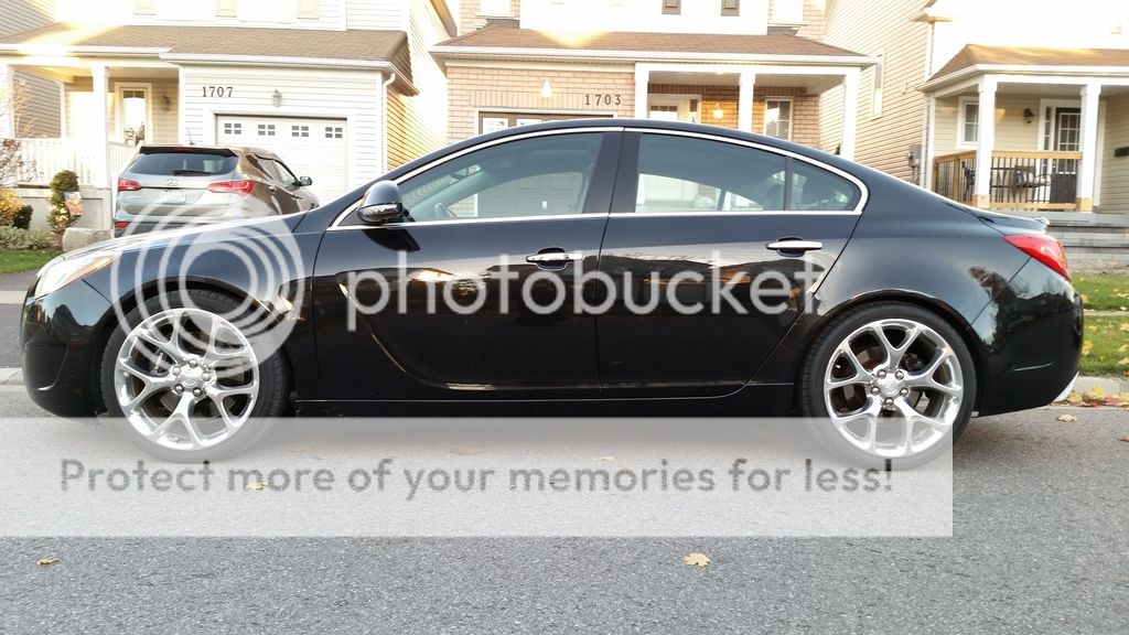

I thought I would post up some pictures of my '12 GS with the Eibach Pro Kit springs installed. I've gotten a few questions on them recently, and I know there aren't many pictures of them online (the H&R's seem much more popular). Just to give some background, these are of course "designed" for the Opel Insignia 2.0T, which as we know is the "same" car. The specs on them were:
Eibach PN: E10-65-019-15-22
Drop F/R: 30mm / 30mm
I purchased them online from Tunershop.com, who seemed to have the best prices and shipping rates. Overall I got the set shipped to Canada for about $250 USD.
I went with the Eibach's because I wasn't liking the "reverse rake" that a lot of people had been getting with the H&R set, and I was hoping these would be better. You can be the judge for yourself, but I definitely think the Eibach Pro Kit delivered a more even drop. I think due to the quarter panel / fender / wheel arch design of the car you're going to have the "illusion" that the rear is lower than the front to some degree no matter what you do, but these springs do help mask that.
I've had them installed for a few months now, so these pictures are fully settled in. I noticed very little difference in ride quality / stiffness in "normal" mode, but in GS mode the car rides very nice and stiff - obviously uncomfortably so on bumpy roads, but it handles like it's on rails. Very similar stiffness and cornering ability to my previous car, a Honda Civic lowered on coilovers, which was a much lighter car.
I also have Eibach Pro Kit 20mm wheel spacers installed on all four corners, which has brought the wheels out flush with the arches. I personally like the look, but 20mm is definitely the most I would - the fronts are almost poking out a little. Those who want a slightly less aggressive look could likely go with a 10mm or 15mm spacer.
The pics (sorry for the cell phone quality / poor lighting):

Awesome. Thank you for the pics. Car looks real good. I just bought some spacers to see which length is go with. Front would be 5mm and back is 10mm... but yours looks real aggressive with the 20mm. Thank you sir. I've made up my mind
