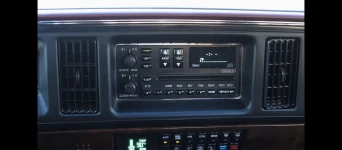

Hello! I have just recently purchased a 1994 Park Avenue and would like to listen to my ever-growing collection of CDs. There is one problem though, in that my car has only been optioned with the cassette deck and radio. I have been made aware though that there is a CD player/radio unit for this car, as shown in the attached image. Would anyone happen to have this unit in their PA to check or know the part number for this unit? (Or maybe could recommend alternative Delco units that could work, I'd like to keep the radio looking as stock to the car as possible.) Searches through many sources have all come up dry 🙁

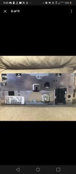

Update: I have come across the model on eBay, but have a follow-up question as I am new to the world of car stereos: I have noticed that this radio and my current cassette unit have different connectors on their back sides. Does this mean that the CD player would be incapable of interfacing with my car, or do I need some sort of adapter?
For reference,
CD player back
vs the back of my cassette unit:
Again, thank you all for your help.
They are compatible. The main connector is simply oriented differently. The extra, smaller connector on the CD unit is for steering wheel controls. No effect without connection, just built into the design.
