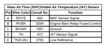

Ok I've got a back probe pin kit from harbor freight. the pins from above on the connector are
What is "Low Reference"
Is B 12 volt from battery?

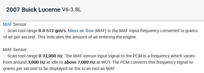

Something does not add up. My scantool D8S Xtool reads about 5gm/s at iddle. How many gm/s is at 3000Hz per Alldata.
