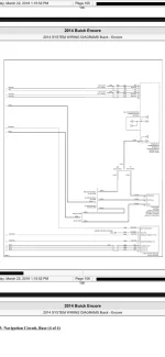

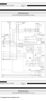

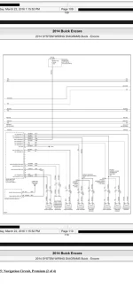

2015 encore

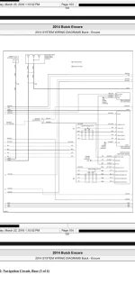

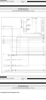

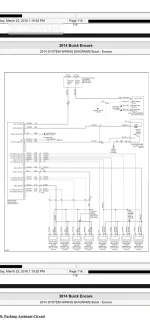

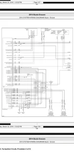

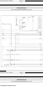

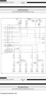

I was trying to add a LOC to my 2015 encore and when I unplugged the harness from the back of my original head unit I cut the wires to try and find the rear speakers and never was able to find the speakers so I was connecting the head unit back up and I have several extra wires that I don't know where they go is there anyway I can find a wiring diagram for the 26 wire pin that comes out of the back
If you look on my profile, I shared the entire service manual for 2012-2016 Buick encore/chevy trax…. I hope this helps. I drove myself crazy trying to find anything with accurate information and it seems like nobody wants to share the information they do have but I am not greedy lol
