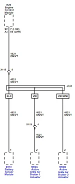

the lin network this runs on is luckily very simple. one wire directly from the engine control module to the back of car to the negative battery sensor, than 2 other wires, one to each shutter. although there is only one shutter in the front afaik. so only 2 possibilities that the network would act up and potentially get shut down. the motor can be bought on ebay for cheap but that is what i installed inside this shutter assembly originally about 2 years ago after i reassembled the front end. the motor failed in a way that took down the network. the lin network wire that connects directly back to the engine control module is in the middle of the harness with the other 2 being power [purple] and ground [black] for the motor. applying voltage to the motor will not turn it on since there is some sort of control board inside that is expecting the signal wire to actuate and tell it what to do hence why testing from below with an oscilloscope could determine if the network signal is making it down there along with checking power and ground. if you have another motor or assembly though, quicker to simply plug new one in when car is cold start and see if it closes. when car is in off state it should open back up but unsure of the time and how long car needs to start ect for it to open back up, data i had didnt specify that much.

junction from shutter is directly to the side of the housing that holds the shutter, unsure where the other junctions are, didnt need to delve further currently. but there are not many and circuit is very easy for once lol

attached 3 pictures and 1 wire diagram for lin bus -
