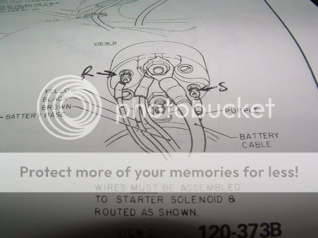

I think I would check the "fuse links" that connect at the starter. IIRC there are at least two and if the one for the starter circuit is blown or burned out you won't have any power but could have power elsewhere. You could run a jumper from the solenoid purple wire to the main power from the battery to the starter and see if it will crank. If not you're not getting 12v to the solenoid.
I would take a voltmeter at trace the power to see where it's lost. If you don't already have it, you should try and get a hold of a chassis service manual for the car. I've got one for my 68 and it has all the wiring listed in it (much simpler than today's cars!). It won't list any modifications like internally regulated alternator or HEI, but it'll probably be fine for most of the car. you can then trace the power back from the starter on the diagrams.
At the starter solenoid, you have one big connection. The + battery cable, and the 2 main power feed wires go there. Then there are 2 smaller connections. You have one connection at each of these. One wire is purple, and the other is yellow.. The purple wire should show battery voltage when the key is turned to crank. If it doesn't, you are losing voltage somewhere up stream of that wire. If you have voltage there, and the other connections are clean and tight, then the starter motor and/or solenoid are faulty. You can even short between the purple wire terminal and the positive battery cable connection, and the starter should crank.
