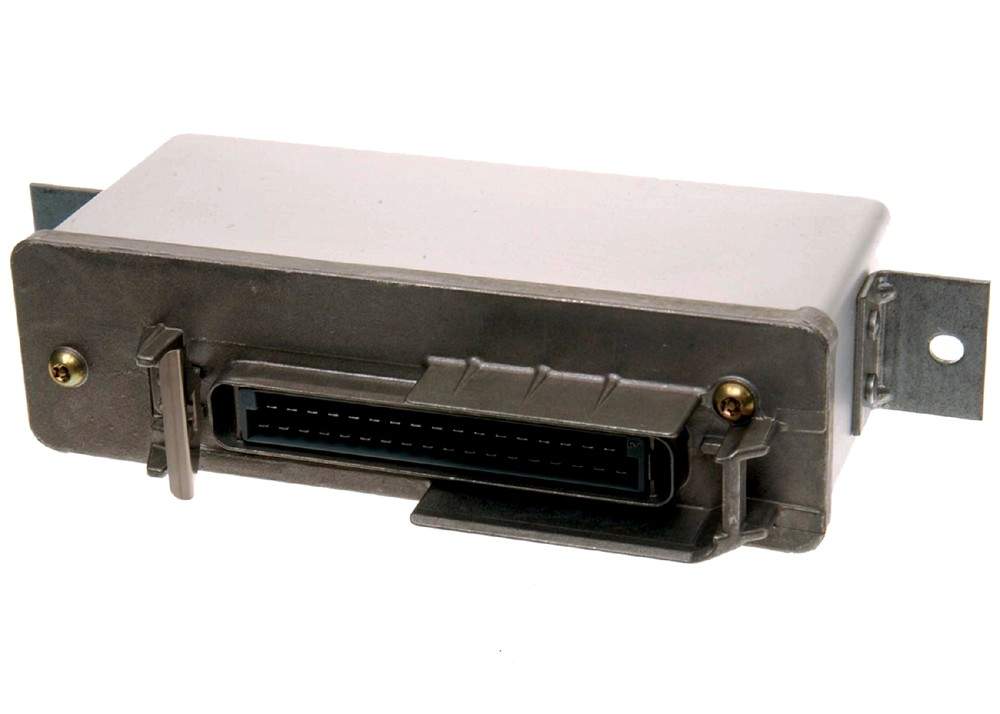

I think you and the dealer(s) are confusing Part #10232762 "MODULE. Electronic Brake Control" Item #2 (View A) with Part #12455422 VALVE Electronic Brake Control Item #16 (View E). They are two distinctly different parts. In addition, Part #10232762 is also a "MODULE" but it is not compatible with the 1994 RMW. It shows that it was used for 1991-1992-1993 only.
http://parts.nalleygmc.com/products/MODULE-Electronic-Brake-Control/2562048/10232762.html
BTW, the compatibility list I posted for the (VALVE Part #12455422 Item #16), was copied directly from the GM parts site. So therefore, the part is the same on all cars listed!
Here is a pic of Part #10232762 "MODULE. Electronic Brake Control" Item #2 (View A)
