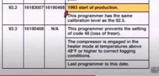

The heater core leaked into my HVAC programmer and fried it so I started hunting around but they're almost impossible to find. I was unable to find any programmers with the same model number as my original one (16182834)
The local junkyard had quite a few buicks but none to match so I ended up getting a climate control unit (C2) and the hvac programmer (16207743) from a 95 Park Avenue Limited without Dual Zone climate controls (C68) [Climate control head C2]

From what I can see on my diagrams and what I counted in the vehicle, I'm missing 7 wires for the HVAC programmer and 1 for the control unit.
I do not care about the Dual Zone working. Just want to be able to control it from the main control head. Don't care about the passenger panel or even if its wired in or not.
I attached all of my diagrams and connector views for any reference.
