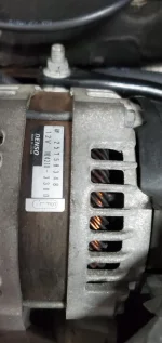

Well, my OEM Denso alternator (Made in Japan label) part # 104210-3300 is starting to make a bearing noise that gets pretty loud. Time to replace it but what alternator is it best to go with?
My current part # shows it is a 130 amp alternator.

do you specifically want to have that kind again?, there is a thread on park avenue forum about this
An Ultra should have eithr a AD237 or a Nippendoso(I spelled that wrong) model that I showed before.
heres the Japanese alternator, 140 amp, if needed:
Part# 334-2858 - ACDelco
Part# 19343570 - GM
OEM: 25758345
This is what an AD237 looks like:
thats my original AD237 on my 1999. A 2004 may, if it has it, look different, but if it says Delphi on the front case you have An AD, if it doesnt, it may be the other. Pic of yours?
An ultra SHOULD have one or the other, so that should help reduce the possibility of fitment issue. The Japanese alt appears ot have the same mounting ears as the AD237 so you shouldnt have a problem there.

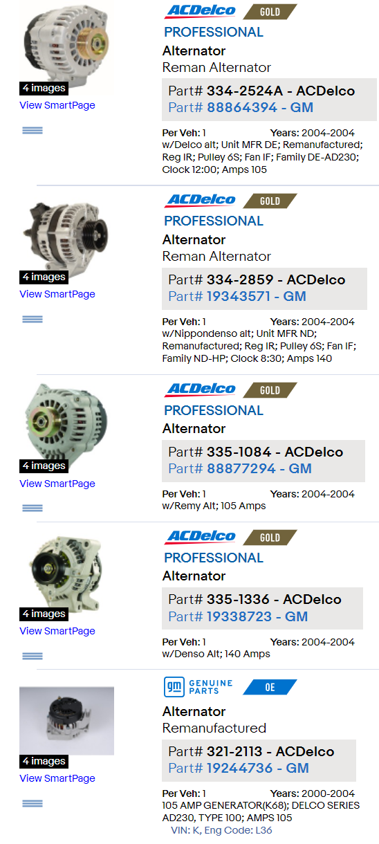

Yours may look like this ish?
I realize that was an 04 ultra, so to double check I went and punched in a 2004 lesabre so you dont get the wrong part numbers/you see the options
It looks like the 140 amp, KG_ whatever 140 was
kg9
Inexpensive at $44 with a core return. Are they US made or overseas?
if you do get that option pay the core charge and get your OE rebuilt. Its still a quality alternator and remans can be ticking time bombs, plus, its a 140 amp factory alternator that works on most 3.8s, easily adaptable even if it wasnt, a different case shell and it can go on any number of trucks etc

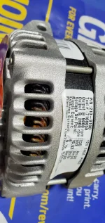

Went to NAPA to check out their alternator:
Suprised the test sticker shows 103 amps at 2000 RPM and only 135 amps at 6000 RPM. I thought a 140 amp alternator would put out more amps at lower RPMs and not require 6000 RPM to see peak amps.
Hopefully the black windings is from spray paint and not burnt windings :0

Rock Auto on shows 105 amp versions AFAIK. Are you sure yours is a 130 amp? I would imagine Rock Auto would list a premium unit if they had one available. From what I know... It's also about parasitic loss on the drive train. Spinning an alternator at high RPM isn't good for fuel economy. More amps at lower RPM would require a whole different alternator wiring. Maybe I'm wrong... but hopefully someone will chime-in.
The part # on my current alternator comes back as 130/140 amp. The broadcast sheet also shows the code (KG9) for the 140 amp alternator.
The Buick's had either a 105 or 140 amp alternator. The LeSabre Limited's probably had the 140 amp because of the heated seats and other electric heavy options.
