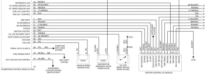

Here's a diagram that may help - this is the ignition control module circuit for the 1998 Lesabre Limited -
Yeah. I already have that information thanks. I need a picture of the circuit block cover that shows the location of the fuse. Otherwise I am going to have to drop the circuit block and see where the pink wire ends up.
