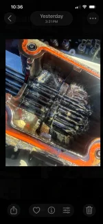

I found a lil white gunk when I took the top off to see the pistons be honest with me guys am I screwed🫩😂
Exactly what did you take off to see the pistons?
Remove the oil fill cap and look for milky substance in the cap......if it's just clean oil then you're okay.
I took the whole thing off there wasn’t any in there I was just able to shake the piston back an forth
This what I saw in the thing that holds the piston down I saw nothing on the pistons at all they where just shaky

That is the valve cover. What you see are not pistons, but valves. To see the pistons, you would need to remove the cylinder head, which is what the valves are installed in.
So what do I need to change for coolent to stop getting in there
What that means is that you have oil and coolant mixing. You need to find out where the leak is and then fix it. It could be a simple fix, or it could be quite involved. You won't know that until you do some digging.
@HotZ28 and @02LTD2.0 have shared some good ideas on where it could be leaking.
Actually what they are seeing are rocker arms. Come on @DrivenDaily , you're better than that!
