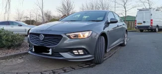

TourX Essence with Opel Insignia DNA.
This is an interesting retrofit item; DLR, doubles as turn signals and fog lights. Aliexpress sells them cheap $75 per pair.
Specifications:
Continuous lighting
Working Voltage: DC 12V
Color Temperature Range: 6000~6700K
Brightness: 70~90 LM(left and right strict symmetric )
Working Current: DC 150mA~300mA
Duration of work: ≥24Hours
Working temperature: -40~60°
Light Color: White/Yellow
Material: ABS + LED

I’m curious to see if they are plug and play, or if they require some splicing. Do you have a link to order them?
Definitely not plug and play... in the one pic I can see flying leads. They look interesting but the life is extremely low, maybe it is just a misprint but 24 hours of run time isn't worth doing IMO.
Correct, these assemblies are not plug and play... However, the British guys stated that the installation was easy. Modern LEDs are designed to work for at least 10,000 hours. I guess they mean that these lights can be run 24/7
I can see that there are 5 leads coming from the control box:
1. (-) Ground
2. White DLR low power (L+R lamp assembly)
3. White Fog Lights full power (L+R lamp assembly)
4. Ambert left turn signal
5. Ambert right turn signal

Not to mention that the design looks hideous to me... 😓
Looks too much like a Kia product.
