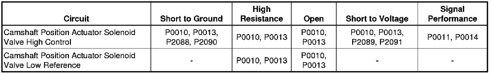

Circuit/System Testing
1.Ignition OFF, disconnect the harness connector at the appropriate Q6 Camshaft Position Actuator Solenoid Valve. It may take up to 2 minutes for all vehicle systems to power down.
2.Test for less than 5 ohms between the low reference circuit terminal B and ground.
If 5 ohms or greater
1.Ignition OFF, disconnect the harness connector at the K20 Engine Control Module.
2.Test for less than 2 ohms in the low reference circuit end to end.
• If 2 ohms or greater, repair the open/high resistance in the circuit.
• If less than 2 ohms, replace the K20 Engine Control Module.
If less than 5 ohms
3.Ignition ON.
Note: A test lamp must be used for this test. The control circuit is pulled-up to a low current voltage, 1.5-4.5 V on the control circuit is normal.
4.Verify that a test lamp does not illuminate between the control circuit terminal A and ground.
If the test lamp illuminates
1.Ignition OFF, disconnect the harness connector at the K20 Engine Control Module, ignition ON.
2.Test for less than 1 V between the control circuit and ground.
• If 1 V or greater, repair the short to voltage on the circuit.
• If less than 1 V, replace the K20 Engine Control Module.
If the test lamp does not illuminate
5.Remove the test lamp.
6.Verify the
scan tool parameters listed below do not display Malfunction when commanding the appropriate Camshaft Position Actuator Solenoid Valve ON with a
scan tool.
Intake Camshaft Position Actuator Solenoid Valve Control Circuit High Voltage Test Status
Intake Camshaft Position Actuator Solenoid Valve Control Circuit Open Test Status
Intake Camshaft Position Actuator Solenoid Valve Control Circuit Low Voltage Test Status
*Exhaust Camshaft Position Actuator Solenoid Valve Control Circuit High Voltage Test Status
*Exhaust Camshaft Position Actuator Solenoid Valve Control Circuit Open Test Status
*Exhaust Camshaft Position Actuator Solenoid Valve Control Circuit Low Voltage Test Status
If Malfunction is displayed
2.Test for less than 2 ohms in the control circuit end to end.
• If 2 ohms or greater, repair the open/high resistance or short to ground in the circuit.
If Malfunction is not displayed
7.Ignition OFF, remove the Q6 Camshaft Position Actuator Solenoid Valve.
8.Verify the conditions listed below do not exist with the Q6 Camshaft Position Actuator Solenoid Valve:
1.Torn, restricted, mis-positioned, or missing screens.
2.Engine oil leak between the oil sealing lands of the solenoid. Inspect the lands of the solenoid for nicks.
3.Oil seepage at the solenoid connector.
If a condition is found
Replace the Q6 Camshaft Position Actuator Solenoid Valve.
If a condition is not found
Note: After swapping toe solenoids, install jumper wires to the appropriate terminals of the harness connectors and the solenoids.
9.Ignition OFF, swap the Q6 Camshaft Position Actuator Solenoid Valve with the Q6 Camshaft Position Actuator Solenoid Valve that is operating correctly.
10.Engine idling.
11.Verify the
scan tool Camshaft Position Variance parameter is less than 2° in each of the commanded states when commanding the Camshaft Position Actuator from 0-20° and back to 0° with a
scan tool.
If 2° or greater
Replace the mechanical camshaft position actuator.
If less than 2°
12.Test or replace the Q6 Camshaft Position Actuator Solenoid Valve.
