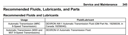

The GS has the 9 speed which is a completely different animal than the more talked about 8 speed Aisin gearbox in the TourX, different fluid as well. 1711045191130.webp
Thanks for pointing out the differences. Much appreciated!!
