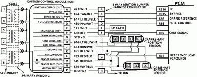

Seven year old thread here! LET ME MAKE THIS PERFECTLY CLEAR, the ICM mount has nothing to do with the ICM ground after 1993. GM finally realized they needed to install a dedicated ground to the ICM that is grounded to the engine/chassis/PCM. All after 1994 had that dedicated ground. Look at terminal L/M on the schematic below, that is the ground!
What shows/means is the ground location is beneath the ICM mounting plate I have 1999 buick park avenue ultra and that is where it is physically grounded from the ICM harness. It’s not grounded through the PCM like some sensors.
Do you have a ground problem to the ICM, or are you just trying to elaborate on the locations of the ground connections? 😕
