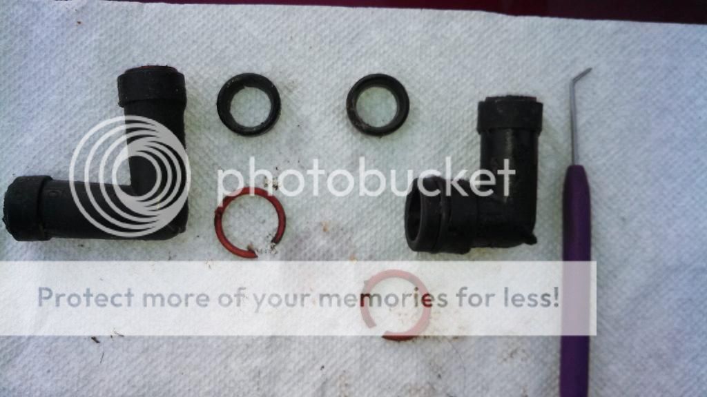

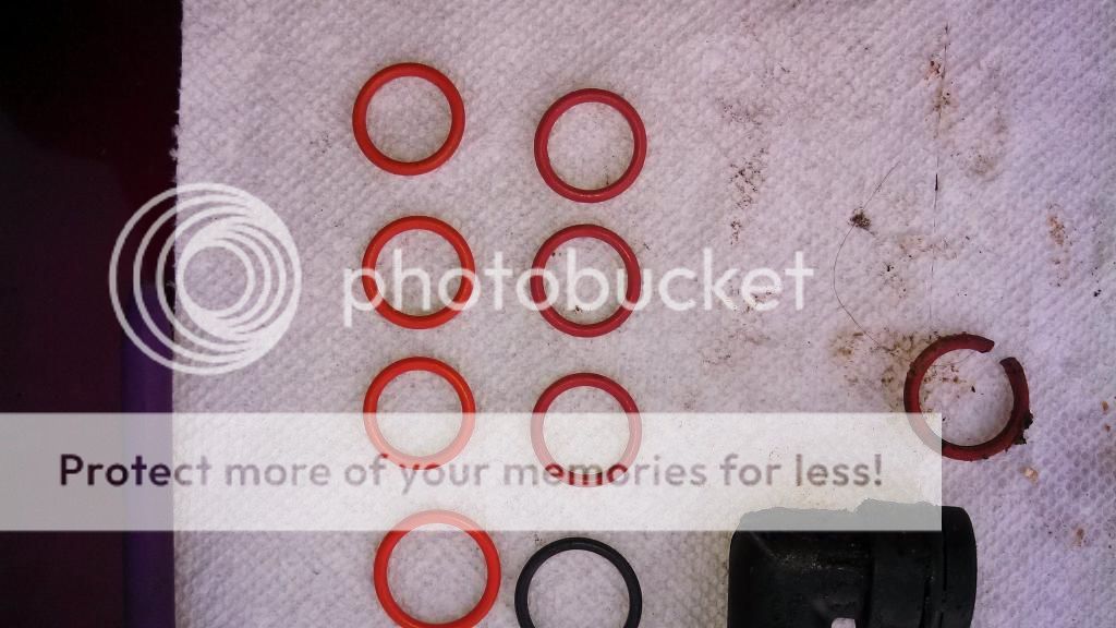

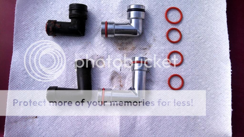

Had the joy of replacing those and doing the water pump while there. All and all, not too hard of job. Did by the Dorman elbows but did get the GM o-rings. Can definitely feel the difference between the GM and Dorman o-rings.
GM o-rings on the left

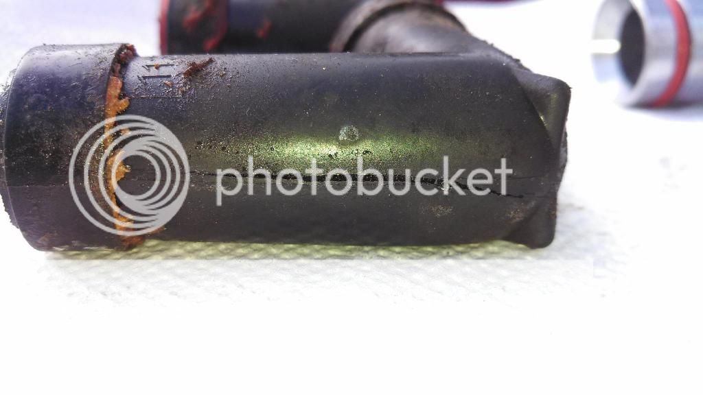

Did manage to pull the broke off pieces out in 1 piece.....maybe from cutting the o-ring first??

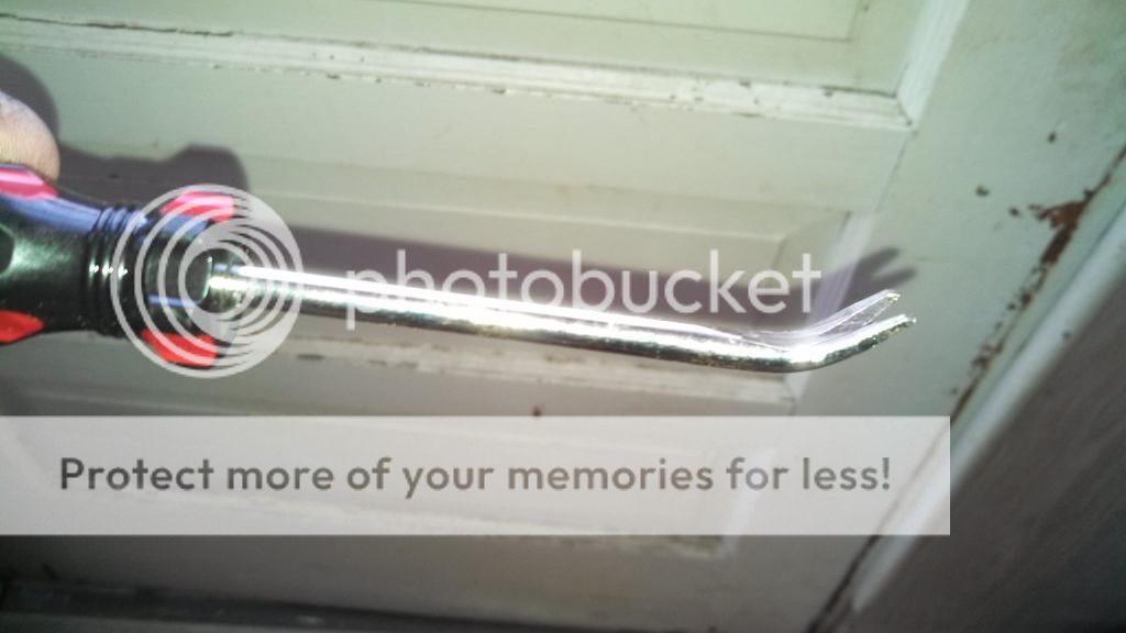

This is a "Tack hook" $5 Came in handy for pulling the last piece out

I used the new aluminum Dorman tubes on the last car I did.....let's hope they last longer thna the year the non-GM plastic ones seemed to last.
I like the idea of using the GM o-rings so I think I'm going to order a few for my toolbox (I always keep a set of coolant tubes handy.....too many 3800's in the family not to have a set).
