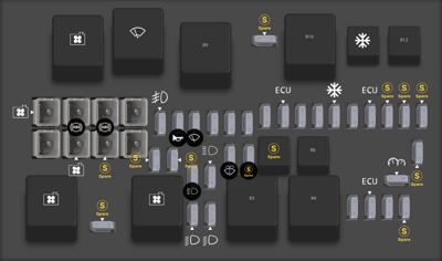

The cruise control on my 2007 Lucerne stopped working suddenly. I would like to start the repair process by checking the fuse. Which fuse controls the cruise control? Thank you.
Here is the link for the rear and under hood fuse boxes. There isn't one that is listed that I can find for the cruise control.
A more common problem is that the brake pedal senor is causing the brake light to be on which could cause the cruise control to not operate.
