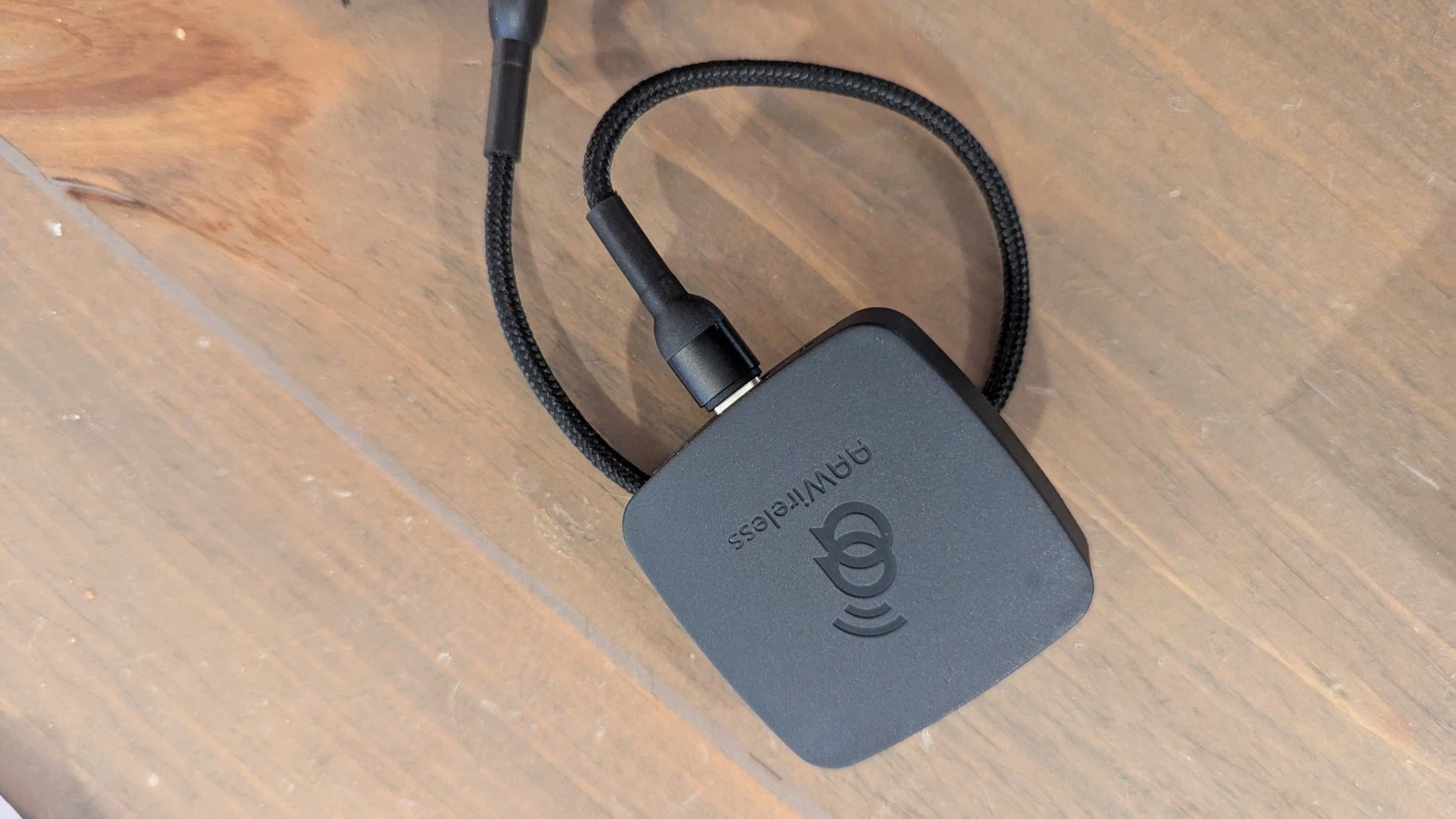

Adding a wireless AA adapter is one of the best upgrades I've made!
I've been using the first-generation AAWireless for a few years. While it's pricier than generic Chinese adapters, the product stands out for its excellent support and consistently updated app and firmware.
