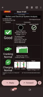

I am attaching pics of battery/alternator test and the data stream from my computer.

Here are my suggestions. Minimum battery voltage is 12.6V 10 minutes after shut down. At 12.61V, your battery barely passes. I would replace it, especially if it is 3 or more years old. If the alternator belt is in excellent condition, tighten it to specs. Otherwise, replace it. Test all of the fuses, and replace the bad ones. Clear the codes, and then wait to see if there are any more problems.
