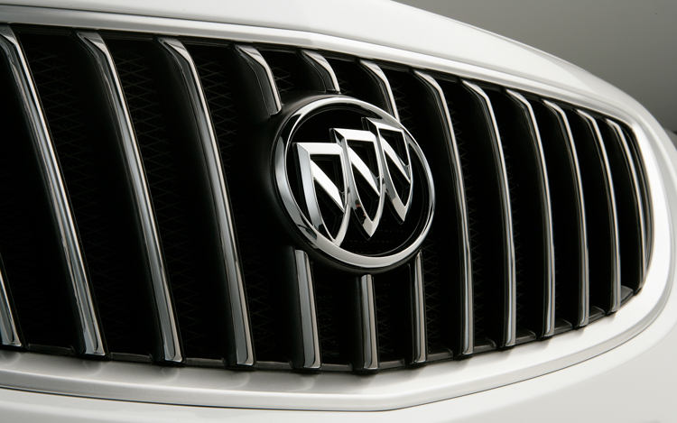

The following. PLastic chrome....so has depth.
Thanks for the pics.
So I didn't see it mentioned anywhere, but why are these different. One actually has a sensor in it or something?
Apparently a radar unit. I've not pulled any covers off (yet) and cannot see any wires running to it.
That kind of makes sense, usually cars with ACC or equivalent have a radar dome in the lower grill area, like in the Durango:
