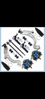

Front suspension tune up
This is a bundle package by Scitto and comes in under 200.00 available on Amazon . Fits your 2000-2005 Buick lesabre . The reviews for Scitto aren’t bad so for a car that’s past the end of its shelf life and in need of a front suspension refresher this is the way to go . This is all easy diy for those that are mechanically inclined and that has a few tools lying around . I recommend an alignment after installation. Also available affordability on Amazon or rockauto are the Gabriel strut assemblies and CV Axles which you should just go ahead and do anyway.
