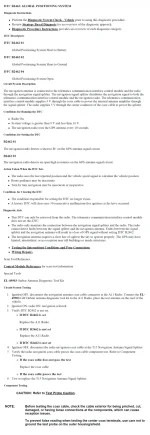

Getting an error in the infotainment system that the GPS is turned off, and also verified through diags and onstar that im getting this error: B2462
I read that this may be due to the cable being unplugged from recent work on the vehicle (prior to my purchasing it) and I wondered where the location of the GPS cabling and module is located in the dash and if it was something that I could look at myself.
With that code there should be an other 01, 02 or 04 To tell you if it is short to battery, ground or open.
