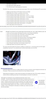

This may not be the answer but should be considered as a electrical short can be anywhere in the system and no way to know over a forum exactly where.
JustAnswer
https://f01.justanswer.com › ...PDF
PIC5009A: Various Electrical Concerns (Inspect Engine Harness ...
