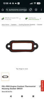

Fyi I found the part number. It's OEM GM part #24505049 and is available also from felpro in the photo below at auto zone
The reason I couldn't find it is because they call it a thermostat housing gasket

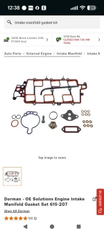

They may be for the heater hose fittings on the tensioner assembly.
Dang I would've bought the gm kit if I would've known that. I bought the felpro kit but had to buy the heater hose and rectangle gasket (coolant manifold gasket) separately and they aren't cheap.
That gasket is included in this kit.
