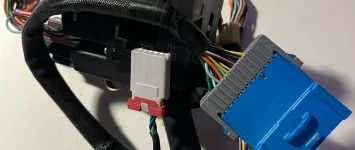

This is a easy one. A few days ago I removed the turn signal/cruse combo switch, multi purpose switch. Installed the new one today. I need help finding the plug for the female 4 pin cruise control connector. I know, just extend the wire harness and it’ll show where to plug in the male side of the cruise control plug. So far it’s not working for me. I’ve searched till I’m blue in the face and can’t find the female connector for the 4 wire plug. My 74 years may force me to turn in my shade tree mechanic card.

Thanks for the reply. That's not a bad video on the actual switch removal. However the Park Avenue switch has a different plug set than the one he shows on his customers car. Ours isn't held in with a screw, it's retained in the high upper left area under the dash with a small stainless clip. Easiest way to find it is to just work the main (largest) bundle of wires out of the multifunction switch. It's really not that hard to remove and replace. Just takes a bit of patience and finesse. Also, this is the second time I've done this little job, you don't have to remove the steering wheel. It's possible to work the top half of the two piece cover out with a couple of screwdrivers that you use to walk the top piece out of its position on the steering wheel side.

that plug comes back as having 2 wires on it and they are BTSI and Neutral Safety Switch function1766383685132.webpIcant find another plugon the column or switch with 4 wires
BTSI = brake-transmission shift interlock
Same as SOTBTSOOP = step on the brake to shift out of park, but 4 letters is better than 9 letters, eh? 😉
First of all the subject plug has 4 wires, dark green and light green on one side and dk green with blk stripe and light green with blk stripe on the other side. But now....Thanks on the replies but I've given up, throwed in the towel and hollered Uncle. Today I dropped the tray located at the very left side under the dash that contains all the main connectors as they enter main wiring harness where it goes through the firewall into the engine compartment. I expected to find a pigtail with the female connector that I assumed to be hidden there after I stuffed the main large blue connector attached to the new multifunction switch in place without dropping the tray. I thought I could have accidentley have pushed it into a hiding spot among the wires on top of the tray. However, No open 4 wire plug there. I have given up. I don’t believe the ‘98 PA had a place for the subject 4 wire plug. Still no cruise so I’ll look elsewhere.

1766469279716.webpconnector 2 inthis picture is under the left side of the instrument panel. its C202 (The ONLY connector frrom the multifunction stalk to the cruise module)1766469817978.webpso that other connector is NOT what you think it is
