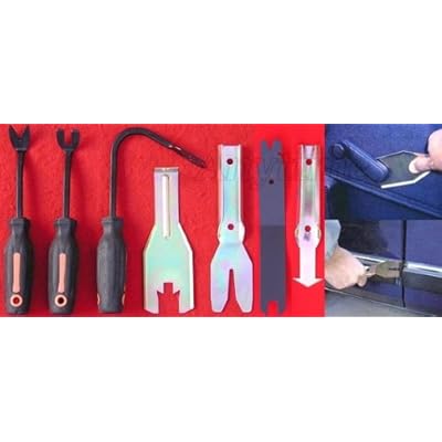

You mention "proper door panel pry bar" - any more info on that?
Peter
If you've got snap on money the big tool manufacturers make some nice ones. If not, I have gotten them at the local auto store, a bit flimsy but they work OK for the weekend warrior. Basically just a forked tool you slide under the panel till you hit the clip and then slide the fork around the clip and pry. You can even make one out of a fairly stiff piece of metal.
you can find the middle one at most auto parts stores.
