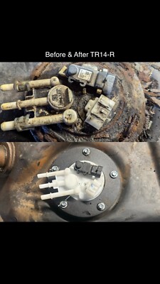

It's getting great gas mileage and the engine has lots of power. I'm getting ready to put in a new OEM ACDelco gas pump (assembly). I've got a new fuel filter waiting too.
Trouble is, the teeth on the gas tank are almost completely gone (with rust). The rust of the retainer ring and teeth are what's holding it together. Unfortunately I cannot find a brand new gas tank, so I bought a used one (in fair to good condition) on ebay. That was about $400. I'm in Michigan, so chances are, the ones in the junk yard are probably even worse than what I'm replacing. The nice thing about it is, I can start out with a nice clean tank.

The fuel tank in these cars is what they put down first, and then build the car around it! The rear subframe has to come down to replace it.
There is a repair kit for the rusted ring marketed on E-Bay and purported to be made by a company in Michigan! I would try this first before trying to take the tank down.
I also used the repair ring mentioned above a few years ago. Working great. Just make sure you have no vacuum leaks. If so you will get evac codes. I formed a wide bead of JB gas tank weld epoxy around the plate before installing.
Wow! I wish I had posted this before I puchased the gas tank. Good information. I'm going to give the ring repair kit a try!
