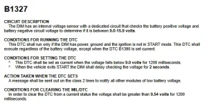

🫠Ok I understand what you’re saying and I definitely missed judged this has a VATS failure now I’m 100% I’m dealing with BCM failures I think my RIM and DIM have failed I have lost ALL intior power my head lights are stuck on and my horn won’t quit blowing so I need information on the BCMs what their names are where they are at in the car and what they control
