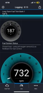

There is an improvement and idle is lower but still seems high, 1200-1300 rpm according to my blue driver. Just a google search says idle rpm should be around 600-800ish, can anyone confirm that?
